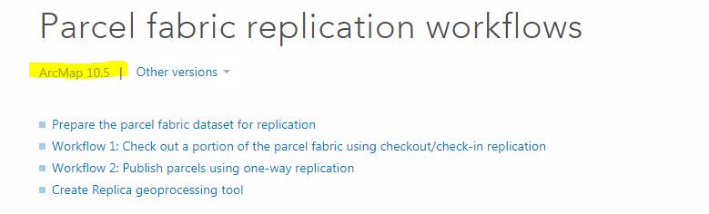

So it turns out that the check out and check in feature actually did work well.  There was no lag in the editing process.  My previous post was the result of trying to create a replica using the replica wizard, not the geoprocessing tool to create the replica.  This resulted in only the historical data getting replicated.  With review I found this document on how to set up a replica with Parcel Fabric:
http://desktop.arcgis.com/en/arcmap/latest/manage-data/editing-parcels/parcelfabricreplication.htm
I did change to help doc for our version 10.5, but there is something on the 10.6 version as well.  I have some more testing to do, but we may recommend switching to this work flow for our parcel fabric editing.
