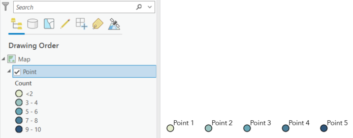

  1. Configure graduated symbols in the layer symbology.

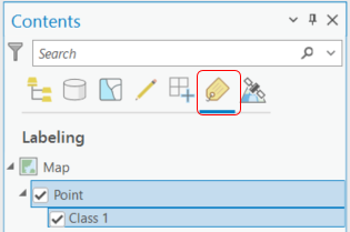

  2. Change the Contents pane to List by labeling.

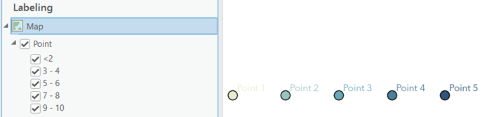

  3. Right-click the layer that has the graduated symbols and choose Create Label Classes From Symbology
  4. In the Create Label Classes From Symbology dialog box, check the Color setting to make the color of the new label classes match the color from the graduated symbol classes.
  5. New label classes will be created with SQL queries that match the symbology ranges and text colors that match the corresponding graduated symbol color.

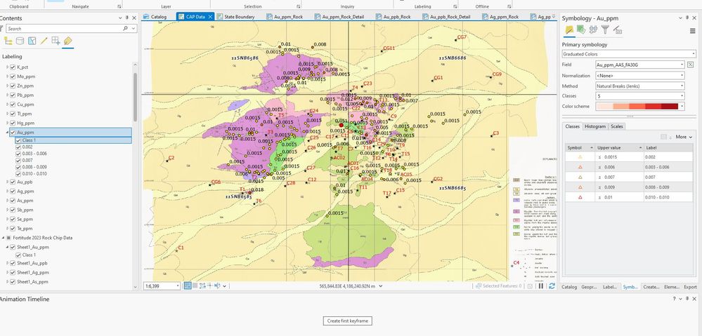

This got me a little further down the line. I now see that the List By Labeling tag is only available in the Table of Contents for a Map itself. I was trying to find it in a Map Frame being used in a layout for exporting a product map. But that would  only be logical since that is where symbologies are illustrated in a Legend.
So I went back and tried it on the source Map. Yeah, the little tag hieroglyphic is there for the List By Labeling view. So after a right click and selecting Create Label Classes From Symbology and specifying Color and not Scale Range, click OK, and it creates a series of boxes corresponding to value range categories created in the Symbology Graduated Colors method and with the 5 classes. See pic.
I don't see the point 1,2,3 etc to the right of the Labeling TOC as is shown in your example.  And it still doesn't get the labels colored. What am I missing?    Thanks;   Dave
