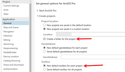

before you create the project, go to the project backstage and change these settings so that a default folder and toolbox aren't created
