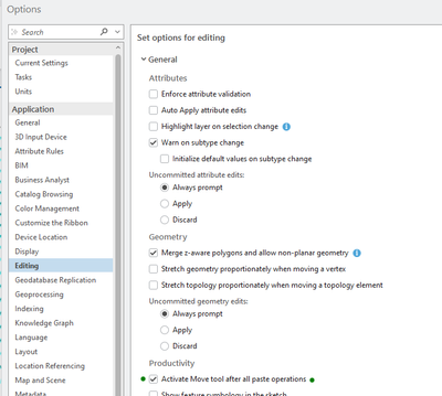

I was doing an editing operation the other day that involved my replacing the geometry of a feature in Table A with a corresponding feature in Table B.
As part of the work flow, I was frequently copying the old geometry from Table A into Table C.
Whenever I did this, my selected editing tool would change to Move instead of Replace Geometry.
Has anyone found a way to (temporarily) set the default editing tool to avoid this kind of thing? Switching back was a huge time sink.
JenniferCadkin
For this workflow, try unchecking the backstage Option Editing>Productivity>Activate Move tool after all paste operations
https://pro.arcgis.com/en/pro-app/latest/help/editing/editing-options.htm#ESRI_SECTION1_5205714C601D...
JenniferCadkin
AlfredBaldenweck
MVP Frequent Contributor
Oh wow that is wonderful. Thanks!
