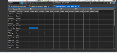

You can set up subtypes through the attribute table. Open the table in Fields View, then select Subtypes at the top. From there, choose Create/Manage and add whatever you need. In your case, you would create two options: Other and Trees (with the built-in taxonomy). Once the subtypes are set up, you can assign domains to specific fields for each subtype through the table.
In the image above you can see my 5 subtypes and the ability to choose  domain for each field by subtype.
