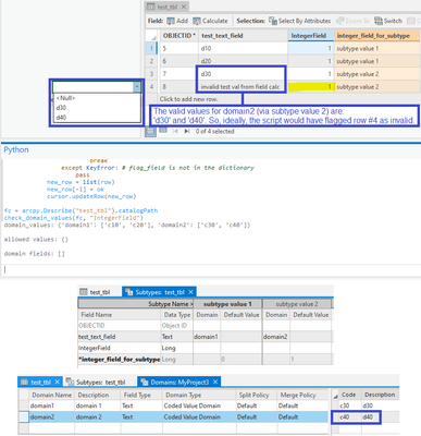

    The table has a subtype.

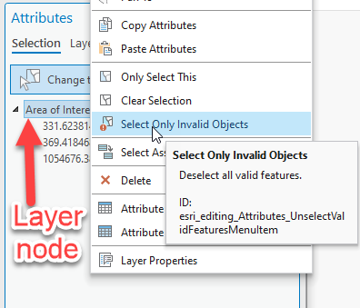

I'm aware ArcGIS Pro has "Select Only Invalid Objects" functionality in the attribute pane (not to be confused with the attribute window):
But that functionality doesn't work for non-spatial tables in ArcGIS Pro 2.6.8 (it only works on FCs)...that functionality was added alter in Pro 2.8.

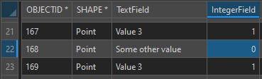

import pathlib
def check_domain_values(in_features, flag_field, database=None):
    """sets the flag field to 0 if at least 1 field value is not in the field's domain, else 1
    in_features: str, path to the feature class or table
    flag_field: str, name of the field that has the flag
    database: str, path to the database. defaults to the parent directory of the feature class, should be set when the fc is in a feature dataset.
    if database is None:
        database = pathlib.Path(in_features).parent
    domains = arcpy.da.ListDomains(database)
    domain_values = {d.name: list(d.codedValues.keys()) for d in domains}
    print(f"domain_values: {domain_values}\n")
    fields = arcpy.ListFields(in_features)
    allowed_values = {f.name: domain_values[f.domain] for f in fields if f.domain not in ["", None]}
    fields_with_domains = list(allowed_values.keys())
    print(f"allowed values: {allowed_values}\n")
    print(f"domain fields: {fields_with_domains}\n")
    fields = fields_with_domains + [flag_field]
    with arcpy.da.UpdateCursor(in_features, fields) as cursor:
        for row in cursor:
            ok = True
            for i, value in enumerate(row):
                try:
                    field = fields[i]
                    if value not in allowed_values[field]:
                        ok = False
                        break
                except KeyError: # flag_field is not in the dictionary
                    pass
            new_row = list(row)
            new_row[-1] = ok
            cursor.updateRow(new_row)
fc = arcpy.Describe("TestPoints").catalogPath
check_domain_values(fc, "IntegerField")

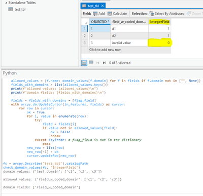

I did a test using ArcGIS Pro on my home computer:
  • ArcGIS Pro 2.9.2
  • FGDB
  • Created a non-spatial table from scratch
  • No subtypes
The script worked fine using the specs mentioned above. So I guess there's something in my work environment that is causing a problem. I'll do some more tests...

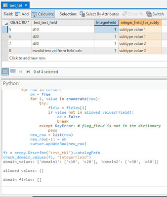

I did a third test (again, on my home computer) where I tested a subtype.
The script ran without errors, but it didn't catch the invalid domain value. But that's totally reasonable, since I forgot to mention in my original post that the data uses a subtype...the script likely wasn't designed with subtypes in mind.
So, to me, that suggests that the error I got in my first test (work computer) might not be caused by the subtype, since the script ran without errors on my home computer where a subtype was present.
