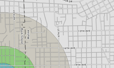

I'm having a hard time getting the map frame to keep its background color once added to a layout. I've got a nice gray color in the Map tab:
On the layout tab, however, it's plain white, even if I change the background color of the data frame separately:
Is this the intended functionality of these settings? There are no polygons or anything on my map covering the "background" - and as shown above, it's looking fine on the map tab. I'm wondering if there's just another setting somewhere that I'm not thinking of.

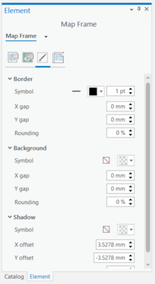

Map backgrounds and map frame backgrounds (map frames are maps on a layout) are currently separate in Pro, that way one doesn't override the other. To change the map frame background: select the map frame in the Layout view, right-click and choose Properties to open the Element pane, then switch to the Display tab where you can change the background.

Yes, I'm not using an Esri basemap on mine either - which is why I need to set a color. My solution for now was to add a graphic rectangle of the color I wanted that covers the layout extent.

@AubriOtis  @DanPatterson  - this is what I'm showing in my second photo. I'm not able to change the background whether I set it on the map or in the data frame properties.

to do it you need to be in the Layout View.  If you want to change the background for the entire thing and not  just your frame that contains the map. you can draw a neatline that takes up the entire page. Make the line no color but the background the color you want.

Yes, I'm in layout view. I just want the map background to be the same color as in the Map tab. My solution for now was to add a graphics rectangle to the map of the desired color, but I feel like there should be an easier way.
