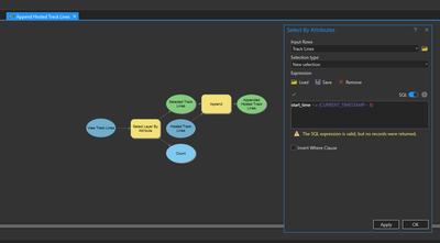

Hello ArcPro Brains,
I am trying to set up a model builder to Select By Attribute all the records that were started the day before. I am using the SQL window to add the code below
start_time <= (CURRENT_TIMESTAMP - 1)
Unfortunately, I am returning zero records and am not sure why. If I simply write:
start_time <= CURRENT_TIMESTAMP
I return all the records before the present. However, I every time I include the addition or subtraction I return the following "The SQL expression is valid, but no records were returned".
I've also tried CURRENT_DATE in the same formula with the same results. Thanks!
RhettZufelt
MVP Notable Contributor
Might try the DATEADD function.
start_time > DATEADD(day,-1,CURRENT_TIMESTAMP)
