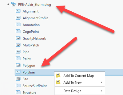

If you "drill" into the .dwg and only add the polyline layer, it only converts the polylines to GIS and doesn't create all the other layers in the .dwg.

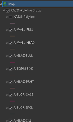

I select only the polyline object type and it still makes a GIS layer for each myriad AutoCAD layer containing a polyline:
It does also make a consolidated GIS layer containing all the polylines, but it still makes a layer for each CAD layer containing a polyline as well.  99.99% of the time I just want a singular GIS polyline layer for all the CAD polylines, irrespective of layer.  The problem is it takes a long time due to Pro's incessant lag that comes from having more than a few dozen layers in a map, to remove all the unneeded polyline layers, and if I don't remove them there's a terrible lag introduced by all the unneeded layers, which can number in the hundreds.

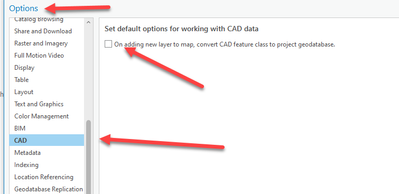

If you tell it not to convert to feature class in options, it doesn't take near as long as it loads the CAD data from .dwg but doesn't convert it to feature class.  Then you could r-click and export the layer desired with all the lines to feature class.

That sounds like a good option - where is the 'convert to feature class' option so I can shut it off?  I can't seem to find it.

In 2.9.3 it is in the options menu below BIM (as in screenshot above).  Don't have 2.9.2 to check, but noticed it is no longer there in 3.1.  3.1 seems to just add the .dwg layers without converting.

I was wonder why I didn't see it...its gone or totally relocated in 3.1, search is not finding any information.
