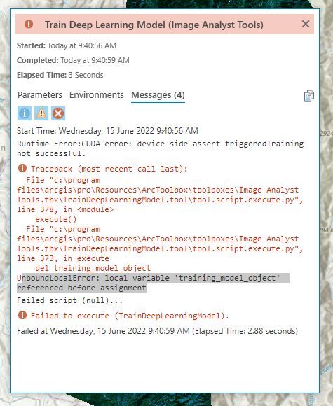

I tried to do the deep learning pixel classification again and here's what I am getting. Do you know any solution for this problem?
Thank you!
andrei_ste
Hi @RDAltarez ,
I also used the Deep Learning Libraries Installer for my specific version of ArcGIS Pro. It is possible that you do not have all the required libraries installed.
You can download for free the Deep Learning Libraries Installer for your specific version of ArcGIS Pro from here:
https://github.com/Esri/deep-learning-frameworks/blob/master/README.md?rmedium=links_esri_com_b_d&rs...

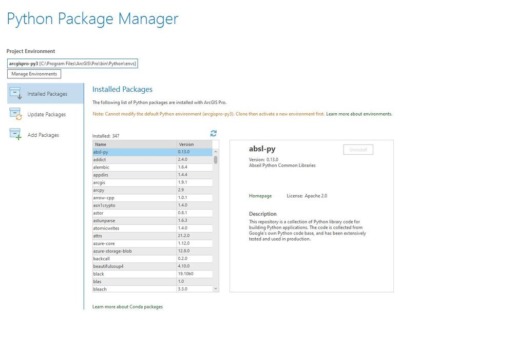

RDAltarez

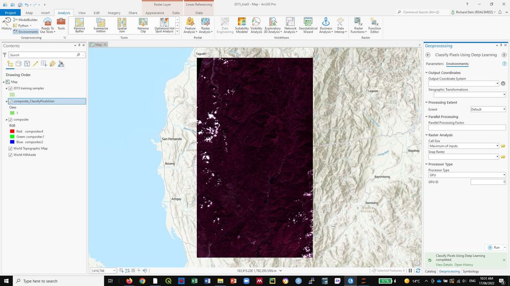

Hi @andrei_ste  thank you for your reply. I did follow this link before doing my deep learning I believe, I have installed 347 packages. Please see below. python packages.JPGI also found other way to get away with the "Unbound error...". I used Jupyter notebook, and used this script (see attached).
Unfortunately, when I used the created model, the resulting image is clear. There's no classified image. See image below.
andrei_ste
I read your first post and you said that you used composite bands to stack your data. I think you should use instead the metadata of your satellite image. Also are you using the pretrained model from Esri or are you using a trained model created by you or someone else? You could use the pretrained model from Esri as a test to check if everything is set up ok: https://www.arcgis.com/home/item.html?id=afd124844ba84da69c2c533d4af10a58
There are detailed instructions on how to use the model in a pdf that you can find in the description. If the steps provided work than it must be something related to your trained model or input parameters.
RDAltarez
Thank you @andrei_ste  for your response. I followed the steps provided in this link https://community.esri.com/t5/arcgis-pro-questions/help-with-deep-learning-and-pixel-classification/.... I was able to generate my classes, at last! I used a TIFF file of my Sentinel 2 (RGB) as my input. Yahoo!
