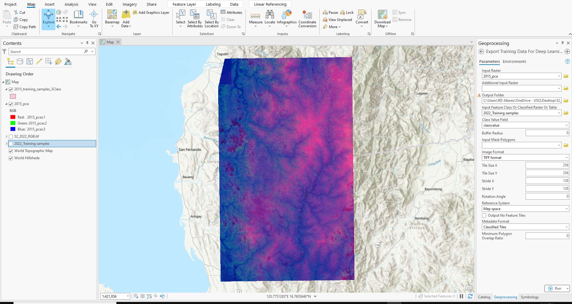

Hi, I am doing a deep learning pixel classification in my ArcGIS pro 2.9.  I export my training data through (see below image):

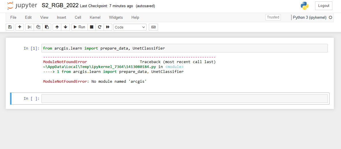

Unfortunately when I am trining my data in Jupyter notebook, I am getting the following error. Pls pardon my being a neophyte in this field, but your kind response to solve this problem is highly appreciated.
To give you more background. I  updated my software to 3.0, and now I am getting this error. Shall I set-up again my deep learning environment?

running in the default environment? or your clone?
how did you install Pro 3?
You can port over your clone to 3.0
Upgrade an environment—ArcGIS Pro | Documentation
