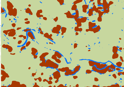

@samaloysius4 your input made me think maybe I'm not doing things as they should for a pixel classification so I decided to add a few more classes (rivers, green fields and woods) , then include your idea of ignore_classes=[0] and amazingly I finally created something! It's not working particularly great as it merged woods and green fields into one class but it is actually identifying other bare fields. I understand now I need to tweak the input parameters to improve it.
But here is an output, kind of works...
So @Tim_McGinnes  & @samaloysius4  thank you for your time, I feel I have a lot more understanding of the workflow of how to use these tools.
