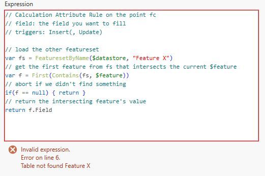

@JohannesLindner  - rather than intersecting I need to use 'contains within'. The source information are names of people which are polygons & we're creating points. Therefore the query will need to be something like  - when a point is created in this particular polygon look up these 2 values - the name of the person who is responsible for the polygon & the polygon area name. These 2 values will the populate the fields in the point class.
AndrewReynoldsDevon
Also does all of the required data need to live within the same project/map service or can the code work with other layers that already exist on our enterprise server?
AndrewReynoldsDevon
The arcade code can't find the name of the feature?

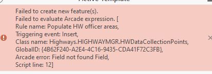

AndrewReynoldsDevon
I have a field in the point feature class with the same name as the field that I'm looking up in the other layer. I specified this field when creating the expression but do you need to specify it in the code?

AndrewReynoldsDevon
The name of the field is the same in both the point fc & the polygon. The value is blank in the point fc but I want it grab the value from the polygon class then return that value & save it in the point fc
