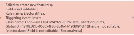

AndrewReynoldsDevon
Both the polygon & the point features are manager connections & I looked at the design of both features & the field's that I'm interested in aren't set to Read Only so not sure why I'm getting the error saying 'Field is not Editable'
JohannesLindner
MVP Alum
Hmmm. I tested the rule again, and it works for me. Are you sure that the field "HWDataCollectionPoints.ElectoralArea" is editable?
