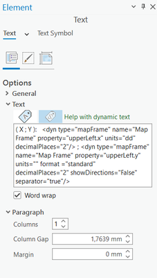

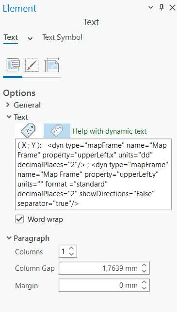

Hello People!
Can anyone help me find a formula in dynamic text to have x and y equal to the print of a layout performed in arcmap.
I try this, but without sucess "  ( X ; Y 😞 <dyn type="mapFrame" name="Map Frame" property="upperLeft.x" units="dd" decimalPlaces="2"/> ; <dyn type="mapFrame" name="Map Frame" property="upperLeft.y" units="" format ="standard" decimalPlaces="2" showDirections="False" separator="true"/> "
Best regards
João

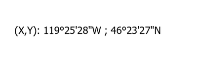

JoaoPinto
Hi @RhettZufelt
Thanks for that arcade, but still have a problem without a detail with my (y) need to have the (-)
Like the next example with your code
I realy need
Best Regards
João Pinto
RhettZufelt
MVP Notable Contributor
Sure, but if you do, you don't want the N/W in there as it means the same thing.
This seems to work.
(X,Y): <dyn type="mapFrame" name="Map Frame" property="lowerLeft.x" units="dms" decimalPlaces="2" showDirections="False"/>   <dyn type="mapFrame" name="Map Frame" property="lowerLeft.y" units="dms" decimalPlaces="2" showDirections="False"/>
