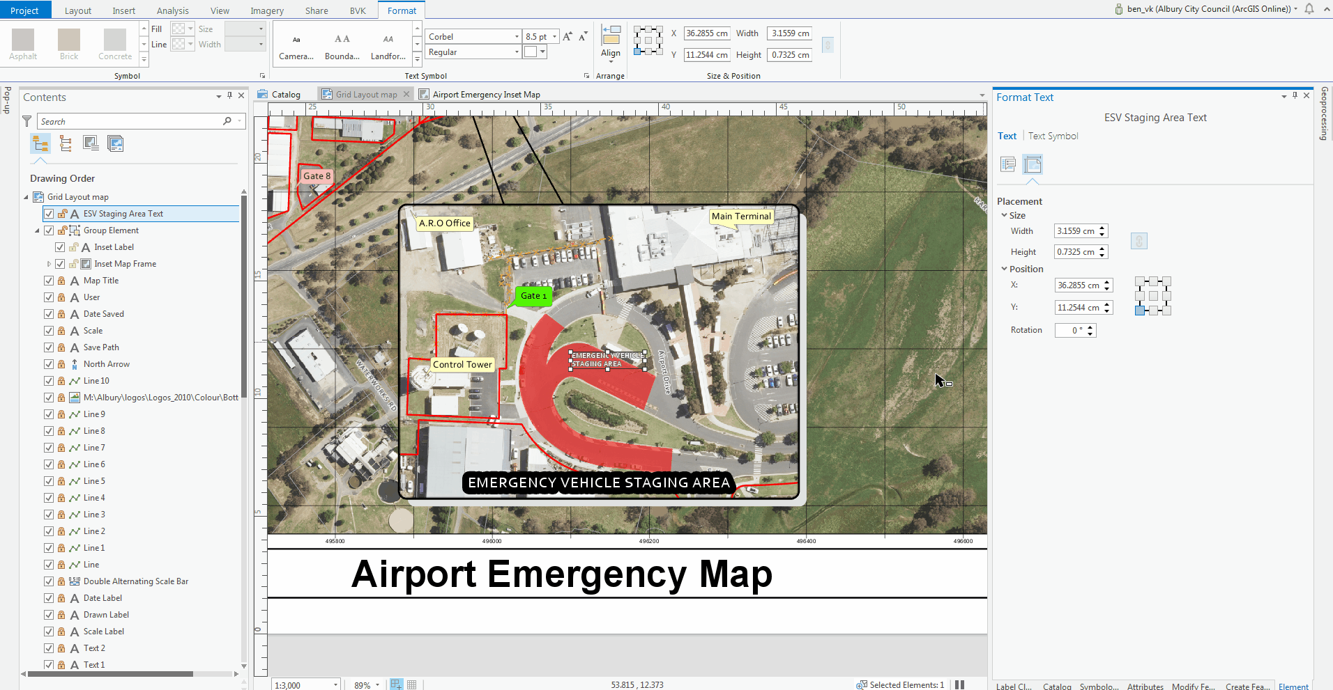

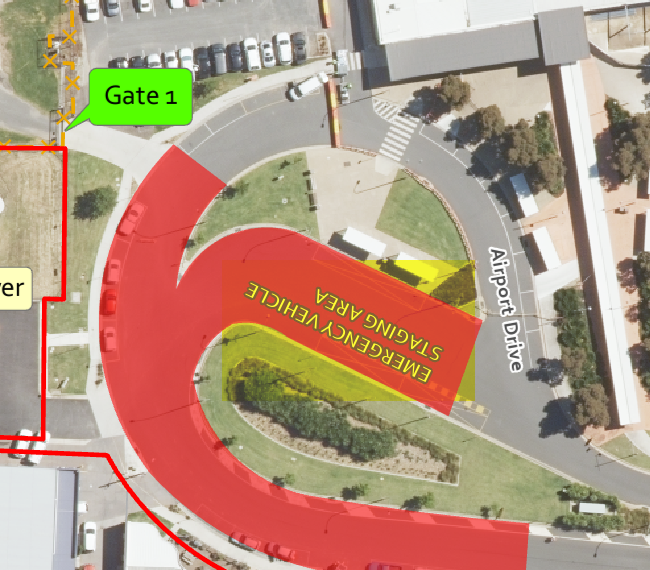

Has anyone tried rotating text in ArcGIS Pro? I am having issues with a simple rotation, i just want to rotate about 25 degrees clockwise to align with a polygon, and each time I do this it flips upside down, video for clarification:
This should be the most basic of tasks, but Pro is making it exasperating!

It looks like you're working with point text:
I agree, I'm a bit exasperated working with this.  It appears that I get a Rotation value for the Text Element as well as the Text Symbol, and that when using Point text, I can't change those two independently.  If I change one, the other matches it.  And when it's upside down, well... I'm stuck.
Try adding your text as Rectangle text, and then note that the Text Element rotation is controlled separately from the Text Symbol rotation.  Let's see what we can do.

Ben, maybe something even easier as we have since further narrowed down the issue here.  This appears to be caused by something in the styles from the symbol gallery.  When you choose the symbol, my guess is that you're choosing it from here:
So, if I choose POI, I get the obnoxious behavior.
But if I choose Water, things are good.
With that information, are you able to proceed with your work?  I hope this is helpful.

TomBole
Hi Ben,
The upside-down, inverted behavior you are seeing is due to the value of the Flip angle property on the Text Symbol.
When the flip angle is not 0 you will get the upside-down, inverted behavior. This is by design since these text symbols are designed for map labeling, not just for text placement on the layout. To avoid this, I would recommend using the layout specific text symbols that you can access from the Symbol gallery.
You can also change the flip angle to 0 for any existing text elements where you see this problem. You can also create your own text styles that you can reuse. Information on how to do this can be found in the following help topic - Save symbols and style items in styles—ArcGIS Pro | ArcGIS Desktop

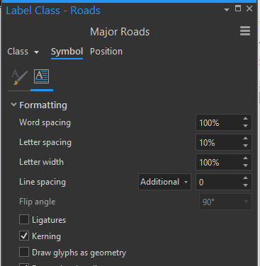

wayfaringrob
Honored Contributor
@TomBole, are you aware of anything that might cause that flip angle property to be grayed out in the label class settings? I'm using auto text to add text in the same style as a label, and they're all coming out upside down because the flip angle is set to 90 in the label style, but I cannot change it. I have to change each one manually after placing. Thoughts?
