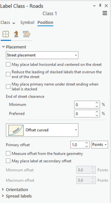

JasonBagwell1
Some things I often do when labeling are to turn off the Stack Label feature, remove duplicates, use a curved offset street placement, and sometimes enable font size reduction.
Like you, I sometimes need to create map books, or field maps for 911.  And, for really busy areas (towns) creating  a few  inset maps  helps.
