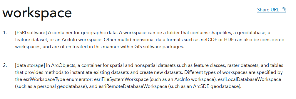

Let's start with definition of the workspace (source: https://support.esri.com/en-us/gis-dictionary/workspace)
So clearly there are 2 definitions, not exactly fully overlapping. And to my understanding, Feature Dataset is workspace according to the definition [1] (stated explicitly), and is not workspace according to the definition [2]. Now let's move to practical consequences. Below is the structure of test geodatabase:

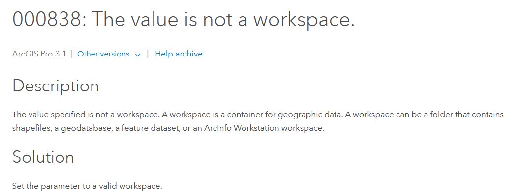

and yes, feature dataset is returned in dirnames rather than filenames (so it is workspace this time). On the same side there is this error (https://pro.arcgis.com/en/pro-app/latest/tool-reference/tool-errors-and-warnings/001001-010000/tool-...😞

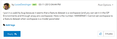

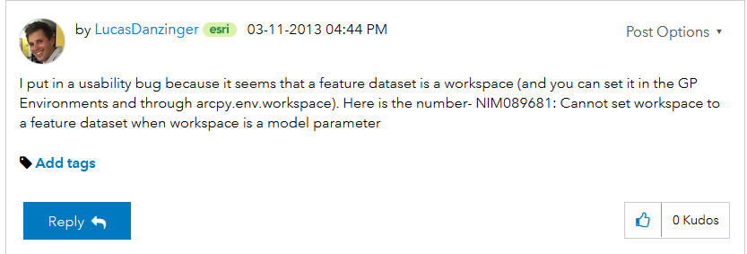

It is only a bit of comfort to me that even Esri employees seemed to be confused sometimes (source: https://community.esri.com/t5/geoprocessing-questions/feature-dataset-as-environment-workspace/m-p/4...😞

NIM089681 from 2013 Will Not Be Addressed
resolution will not be addressed

Of course it won't be. It didn't make sense in the first place. I just used it as the example of how people are confused by Feature Dataset capabilities of sometimes being Workspace and sometimes not.
