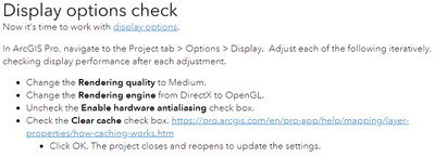

Yeah - having a dedicated card might help.  Did you work with any of the display options:
or anything from the labeling section
Did any of those help?
