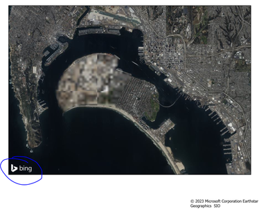

I am using Bing map as a basemap, after recent update of ArcPro to 3.2, I can not remove Service Layer Credits, any ideas? Thanks!

I should be more specific, I can not remove Bing logo from the layout. We did the update yesterday afternoon, all of the PDFs that I exported in the morning are ok, removing service layer credits took care of the logo too, but not after the update. Bing logo is just sitting in the corner. 😭
AubriOtis
Oh, the logo. That's a little different. It's a watermark on the basemap and can't be removed. If you were seeing it removed previously that would have been an error.
