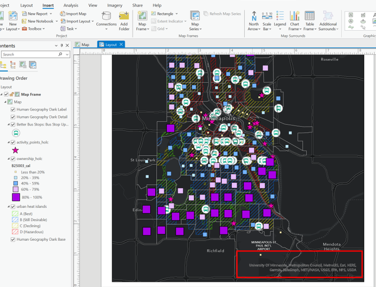

There is probably a really easy way to do this - but I haven't been able to track down the setting yet. Does anyone know of a way to remove the auto-generated text on the basemaps? The one that shows up in the Layout View:
While handy to have - sometimes it would be nice to remove it for map design purposes. Depending on the image composition, it looks really messy and unprofessional if you try to out a legend or other map element next to or nearby it. I've tried to edit it, but it appears to be a static text (is not editable)

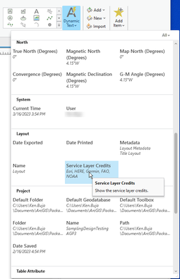

That's the Service Layer Credits. You can resize them or move them behind the map, but I don't think you can delete them. You can get at them by clicking the Insert menu item and opening the Dynamic Text item. It's under the Layout section.
Click on the dynamic text to change it
Maya
Try Dynamic Text then Layout "Service Layer Credits"
