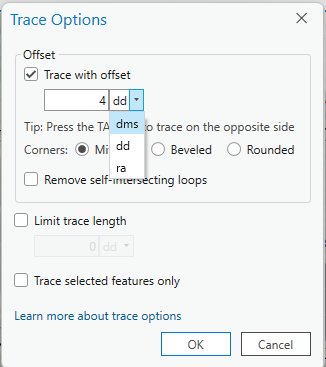

I was planning on adding vegetative buffer on the boundary of a parcel using the Trace tool and using the offset subtool in the Trace Options.

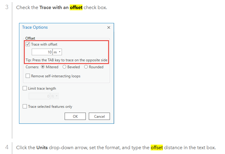

All is going swimmingly until I try to set the offset units as described in ESRI's own manual:
Only problem is, I don't get regular length units, such as meters or feet, but DD, DMS and RA.
Does anybody know why the units would be in degrees, day/minutes/seconds or radians???
Thanks!
Tim

Dan_DMR
It might be your projection. If you are using a global projection instead of something local (for example State Plane projections)?

Hi @TimothyFratta, as Dan mentioned this is due to your Map coordinate system being set as a geographic coordinate system. You will need to change your map coordinate system to a projected coordinate system. Also it is best practice to ensure your data is in the same coordinate system as your map so that your data it not projected on the fly.
