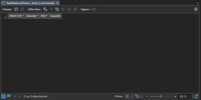

I've created 2 simple stand alone tables. Clients & Orders.
Clients: ObjectId, Name, FirstName, Email
Orders: ObjectId, ClientId, OrderDate
Then I created an attributed Relationship Class between the 2. Like many client can have many orders.And added a IsShipped (short) field to it.
I add a client manually, then I do the same for the Orders table where I set the apporiate ClientId.
Now I want to manually add an entry in the relationship class, but it's read-only.
I don't understand why. We were doing this easily a few months ago and it was working great. Of course we were doing it programatically in a more complexe data model than that but we hit that problem and we are trying to isolate the problem. This is the smaller we came up with. Why can't we add relationship data? Why is it read only??

Just run this script (replace the 3rd line by your database sde file. Then add data in both tables and try to add a record in  rel_Cars_CarColors. It's read only..
