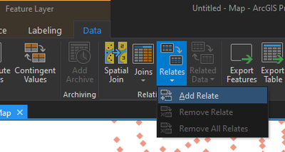

On the ribbon, go to Data → Relates → Add Relate. You can also find this by right-clicking the layer in the Contents pane.
This creates a sort of ad-hoc relate that's specific to the map (as opposed to a true Relationship Class). It can be between any two layers, provided they have a field in common for the relate to work.
