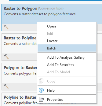

Easiest is to right-click the Raster to Polygon (Conversion) tool and select "Batch"
DanPatterson
MVP Esteemed Contributor
Batch geoprocessing—ArcGIS Pro | Documentation
which is kindof like modelbuilder... but check the requirements to see if it suits your needs
