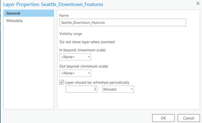

Check if the following steps work for you?
For the layer in ArcGIS Pro > Navigate to Layer Properties > General.
Check "Layer should be refreshed periodically", with a desired interval.

Thanks JayantaPoddar. This unfortunately did not work.

3) For the OGC layers, set the "Layer should be refreshed periodically" to 3 minutes.
