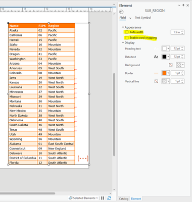

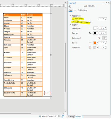

Hi GarthHoxsie-Quinn,
The short answer is yes! You can enable word wrapping in a table frame on a field-by-field basis. To do so, you can select the field you're looking to enable word wrapping for in the Contents pane, right click on it, and open the Properties pane for that field. The new Element Properties pane that appears will have an Appearance section, and within that section will be a checkbox that allows you to turn word wrapping on and off for that field.
It is worth noting that the Enable word wrapping checkbox will be disabled if you have the Auto width checkbox checked on.
Here is the same table before and after I enabled word wrapping for the Region field.
