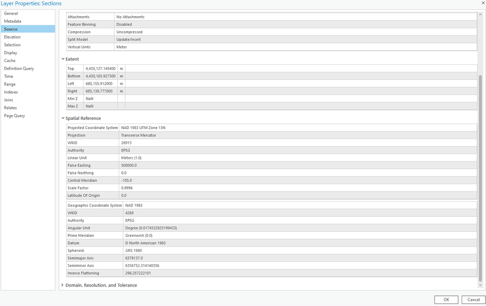

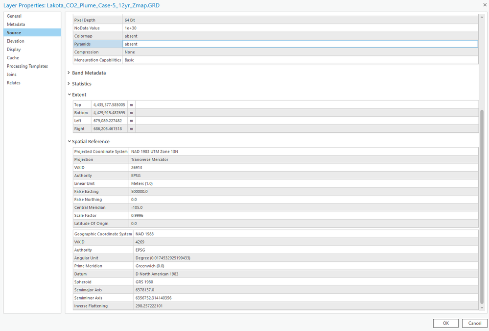

Could you share the screenshot of the layer properties (Extent, Spatial Reference) of a vector and a Raster layer? The issue could be related to a wrongly defined spatial reference.

Ideally it will be overlaying on Colorado in the US. VectorProperties.PNGPlume Properties.PNG
