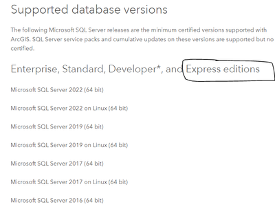

Hi @KoryKramer ,
Thank you. And wait a minute...SQL Server Express is listed as a supported database at ArcGIS Enterprise version 11.1 here: https://enterprise.arcgis.com/en/system-requirements/latest/windows/database-requirements-sqlserver....
Are your colleagues implying that at ArcGIS Enterprise version 11.2 somehow the Express edition of SQL Server is going to disappear from the list of supported databases? There is a migration here and large expense that customers would need to be aware of, if so.
We need to differentiate between the ArcGIS Enterprise licensing and supported Microsoft SQL databases.
If the Express edition of SQL Server is going to remain as a supported database, then this original posts question is valid - why can't we manage it via ArcGIS Pro?
Thank you.
