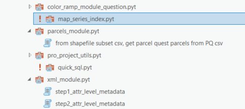

Displaying the broken path symbol (see screenshot).  Right Click --> Check Syntax yields "No syntax errors".  These were toolboxes that functioned fine from 2.9 thru 3.0.2, and then broke upon upgrading to 3.2.  I continued to 3.3 and 3.4, but still broken.  There are a couple toolboxes that did NOT break.  I can't determine why they survived and the others didn't.

Are you able to cut one of these toolboxes down to a minimum reproduction of the error and then post it here?
ZacharyUhlmann1
Hi David.  I think it's more efficient to include the entire .pyt as the they are 180 lines and 100 lines respectively.  I can share a GitHub repo with an example of a functioning Python Toolbox and one that doesn't?  For my part, I manually tried reconciling differences between the two and ruled out culprits.  For instance:

Alright, after swapping bits in and out of toolboxes, I managed to get something that looks virtually identical to your code working (attached). I can't even see what significant changes were made using a file diff tool, I have to assume there's some invalid whitespace characters in your source that I Ship of Theseus'd out of there. Let me know if this still gives you trouble.
ZacharyUhlmann1
Hi @DavidSolari thanks, it worked.  However, I don't know how to apply this to my other .pyt files.  It appears the issue involves line endings, specifically that my files have linux line endings - I think.  I program in PyCharm on a Windows machine, so it could be a setting.  I cannot determine how to simply replace /n with /r/n when converting line endings from Linux to Windows.  Git Diff shows the difference between my files and your as simply the removal of ^M, which is a symbol for a carriage ending used in Windows.
1) What editor did you use to edit my files?
2) If you get a chance, can you simply open and resave?  I wonder if it's that simple.
Something happened between Pro 3.0.2 and 3.1+ which may require tech support because I'm 6 hours into this troubleshooting.

Unfortunately I didn't run any bulk edit, in the process of cutting and pasting different chunks around I must have slowly erased all the bad line endings. I use Notepad++ for general text editing and you can use Edit → EOL Conversion to bulk convert a file. If you need to fix a mixed-ending file something like this should work:

Thanks @DavidSolari . For clarity, the line endings were my suspicion, but not identified as the culprit - since I haven't solved this yet.  I have tried: 1) matching your file visually (i.e. same number lines, etc.) 2) Involved in 1, I changed triple, single quotes to triple, double quotes in the method descriptions. 3) Tried changing line endings - unsure if executed properly 4) Ran your last code chunk successfully, but didn't fix problem.
You suppose this is eligible for tech support?  The issue was caused by upgrading versions.
