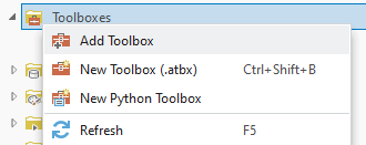

I'm a little confused about part 2, normally what happens is the tool and toolbox are zipped, and then it's sent out, unpacked, and the toolbox and tool can then be automatically added.
They can use "Add Toolbox" and add the toolbox that way, but I could be interpreting this incorrectly, please correct me if so!
