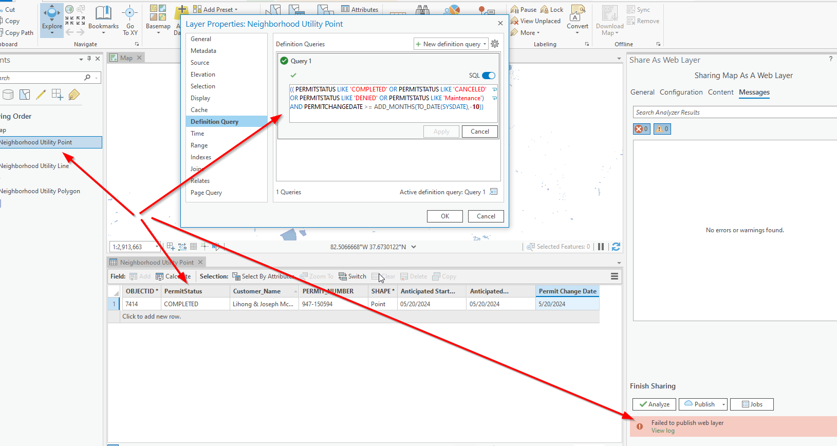

I am getting an error when trying to publish am Oracle SDE Feature Class to AGOL.  It works in CASE 1 below but when I add the date it fails to publish..
NOTE:  It does not throw an error when I add the definition query.  In fact the definition query works fine as you can see from the image below.. there are over 700 records in this dataset and it is only showing 1.
QUESTION: Why does it fail to publish with the date but does not throw an error in Pro
CASE 1
( PERMITSTATUS LIKE 'COMPLETED' OR PERMITSTATUS LIKE 'CANCELED'
OR PERMITSTATUS LIKE 'DENIED' OR PERMITSTATUS LIKE 'Maintenance')
CASE 2
(( PERMITSTATUS LIKE 'COMPLETED' OR PERMITSTATUS LIKE 'CANCELED'
AND PERMITCHANGEDATE >= ADD_MONTHS(TO_DATE(SYSDATE),-10))
9 Replies

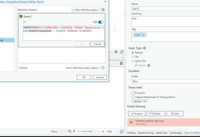

Some oracle SQL may not function correctly in ArcGIS pro, even if it succeeds at a database level
Try using standard SQL, e.g.
(PERMITSTATUS IN ('COMPLETED', 'CANCELED', 'DENIED', 'Maintenance'))
AND PERMITCHANGEDATE >= SYSDATE - INTERVAL '10' MONTH

hmmm failed again...
