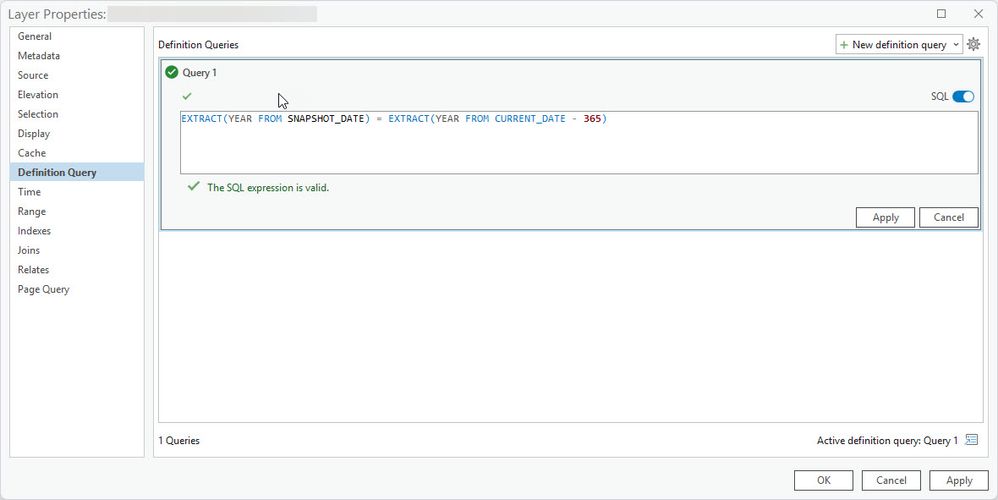

Andrew_McLellan
Hi,
I know this is an old post, but I believe there is a way to do this now in Arc Pro Definition Query with SQL
EXTRACT(YEAR FROM "Date_Field") = EXTRACT(YEAR FROM CURRENT_DATE - 365)
This will allow someone to have way to auto filter years in a date field by the current date year +- however many days. This might be helpful to others rather than hard coding dates in the definition queries if the map is used year over year on a living data set.
