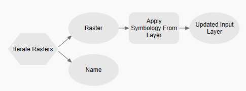

How can we achieve this? I would look at creating a model using ModelBuilder.
3: Create a Model and use the Iterate Rasters Model Builder tool. The tool outputs a reference to the Raster and its Name.
4: Add the Apply Symbology  From Layer tool to the model. This allows you to connect the output Raster as the tool's Input Layer and then choose the .lyrx file as the Symbology layer of the tool. This will hopefully apply the symbology of the lyrx file (which contains the index symbology) to the current raster dataset which is being processed.
It's going to look something like this below:
You can see the model hasn't been connected properly which is why it is still grey.
If you are working with the source jpeg (so that the imagery is not loaded into the Contents pane), you may need to add the Make Raster Layer tool after the Iterate Rasters iterator tool to create that in memory raster layer to which the Apply Symbology From Layer tool is then applied to.
I haven't tried this as I don't have datasets but I think this might be worth a go...
