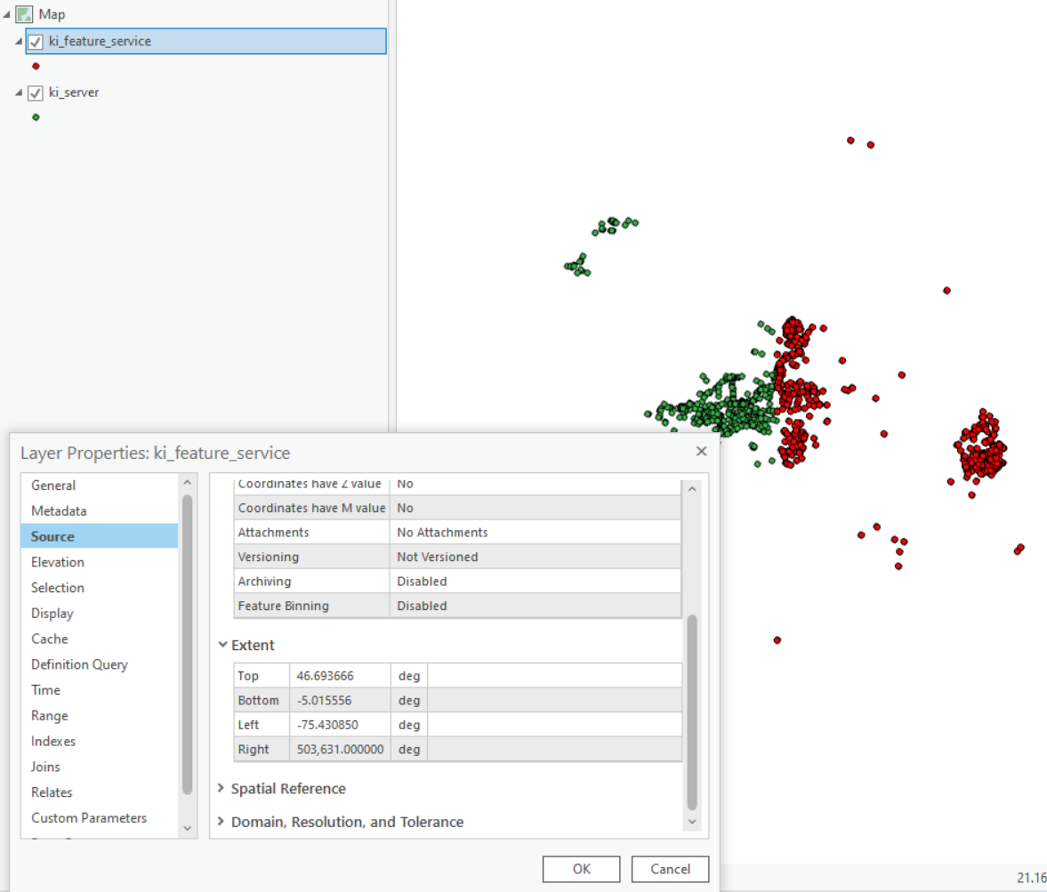

My published Feature Service won't display points with <0 longitude and the extent of the published layer is odd:
Top: 50deg
Bottom: -5deg
Left:-75deg
Right:503631deg!
All the records appear in the attribute table though.

Yes, I've tried this already. The table created by my script looks good on ArcGIS Pro. But when I publish it, the same problem occurs. And when I insert the published layer from portal to ArcGIS Pro, I also have this issue.
Looks like something is wrong during the publication.
