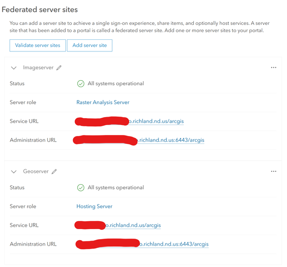

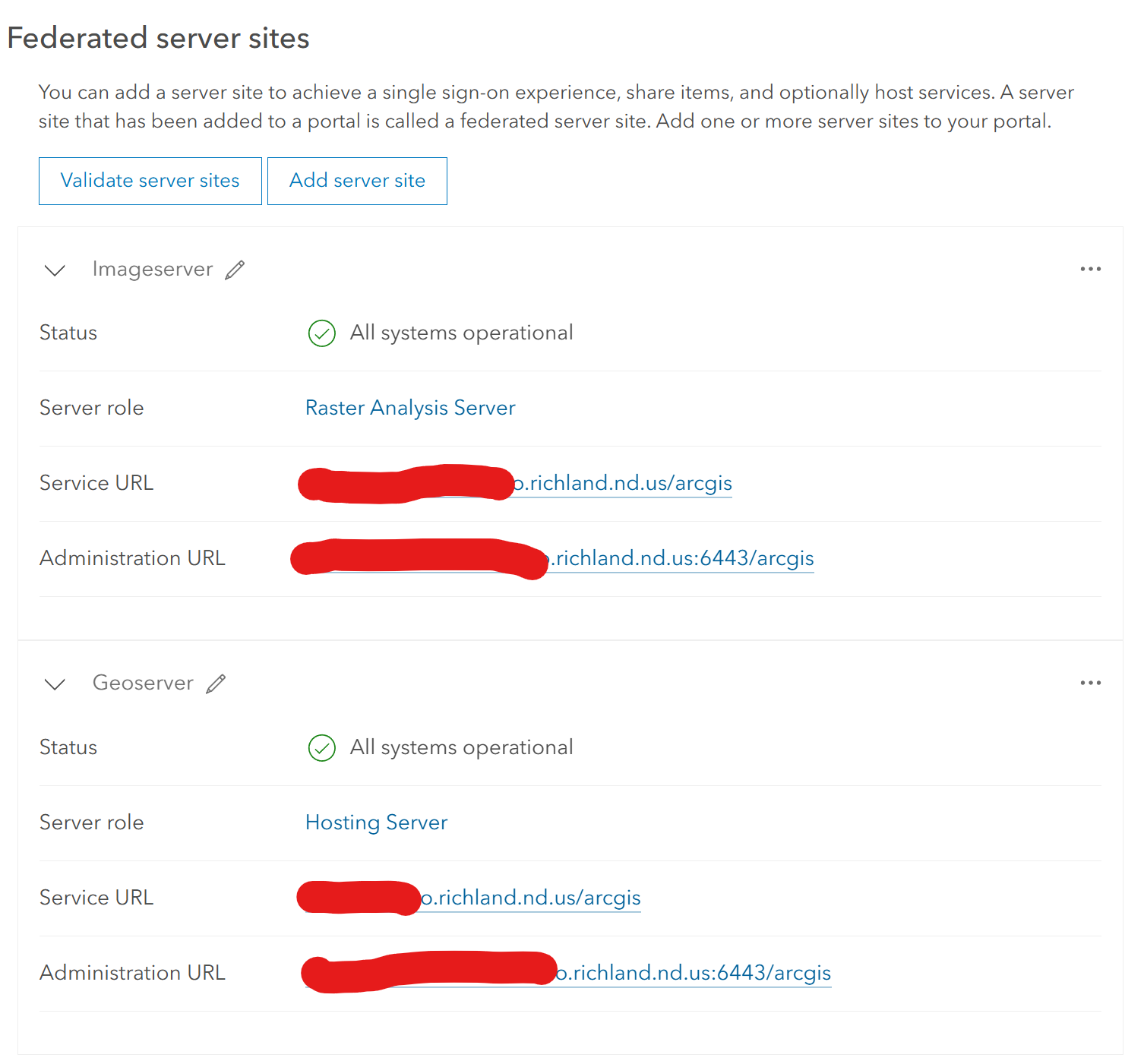

For reference, I have two federated servers.  One is the hosting server and has portal on it, and the second is the Raster Analysis Server.  See below:
