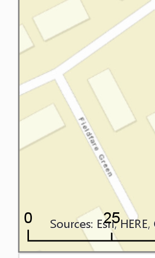

In ArcGIS Pro layout view, my OS Mastermap WMS layer appears very blurry. I need it at 1:1250 scale but it looks like this:
I need the image to be crisp and sharp. The exported image/pdf also displays blurry basemaps.
Same problem when using the open basemaps supplied in Pro.
When in Data view, these basemaps are nice and clear when zoomed in.

TheodoreF
No I can't improve it at all. All my display settings are set to highest quality in Pro options. But that shouldn't affect the output PDFs I export anyway.
For reference here is a close up of an exported PDF map:
Same blurriness at 96, 250, or even 500dpi

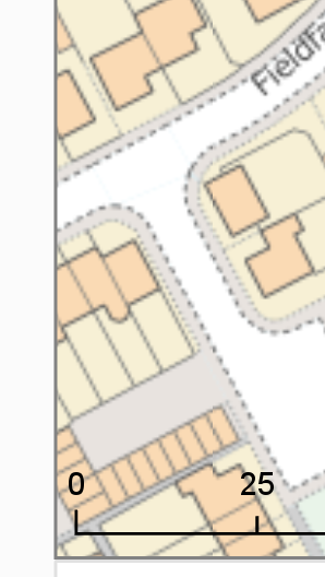

Here is what the basemap looks like in Data view (albeit zoomed in to 1:500 scale, but this is the crispness I'm after)

The printed image is correct... what you see onscreen has been improved by the video drivers as per my link
