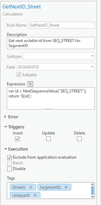

Arcade syntax was all wrong.  (I'm new here.)  I followed the video and it apparently wasn't what I needed.  The other post referenced above had a much simpler version without a variable declaration, one line of code.  Now I know...

ArcPro 2.8.1, I just used the "Create Database Sequence" tool to create a sequence for a couple of features and then used the Arcade expression as detailed in the Esri video below without any extra characters or anything like that.  I just needed a basic unique number.

Here's a screen shot of my rule.

I had read that too and have made...progress?...in that by adding the database owner name before the sequence name, I no longer get the error!  But alas, it also doesn't fill the id either, so I'm trying now to track that down.   I think there's a way to see what number the sequence left off at, I'm curious as to whether that part is actually working and just not passing the value to where it's supposed to go.
KimberlyMeinert
Sequence working on the SQL side...so must be some sort of Arcade syntax issue?
