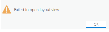

I recently updated to ArcGIS Pro 2.7, now when I open an APRX that is saved with an earlier version of ArcGIS Pro. I can't open the layouts associated with the APRX. I get the following error/warning: Failed to open layout view.  It then refuses to open the layout and closes the tab.
My colleagues are seeing the same error in the APRX files they open.
One colleague who still has 2.6 installed can open the APRX files without any errors.
Is this a bug?

Issue 2: Failure to open Layout View
The following message appears when opening a layout view.
We are trying to get a reproducible case to investigate this further. It may be related to Spell Check and for those running into this issue it may be worth it to disable Spell Checking.  As we have been unable to reproduce the issue we cannot confirm the work-around.
Please let us know if this works or does not work.

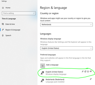

After contact with support we discovered a workaround that fixes both issue 1 (Pro crashes when a layout is opened and text is added) and issue 2 (Failed to open layout view error when opening pre 2.7 layout) as described by @TomBole in his reply.
To resolve both issues (at least for me) install the English (United States) language pack in the Region & language settings. The following settings worked for me (notice that your probably won't need Nederlands/Dutch and the Netherlands as a setting, not 100% sure about the Windows display language):
After you have installed the language pack you should be able to open a new layout and add text without Pro crashing and open layouts in 2.7 made pre 2.7 with text. You can also keep Spell checking enabled with this workaround.
Note: some of my colleagues work in a Windows Enterprise environment with limited administrator privileges, this workaround did not work for them. There might be a link between the limited administrator privileges and installing the language pack.
