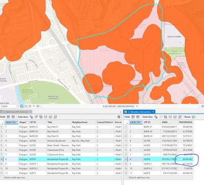

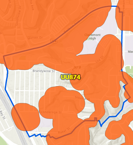

Hi Community,
I am working to update a model.  My goal is to find the Percent Coverage of the District Boundary (Blue polygon) that is covered by the High Fire Zone (Red Polygon).  Ideally, I would like to add a field to the District Boundary with the percentage coverage ie 50%.  The logic will be used in a model throughout the city.
  • Previously model ran an intersection ran between the two polygons and divided the High Fire Zone Shape_Area by District Boundary Shape_Area.  I might have been in GIS too long, and I don't fully trust the Shape_Area is automatically updated as units are edited.

RyanBohan
@IssyAmis Thank you,
The Tabulate Intersections is exactly what I was looking for.  Easy to generate table, quick join and field calculation and I know the percent coverage of High Fire Zone.
