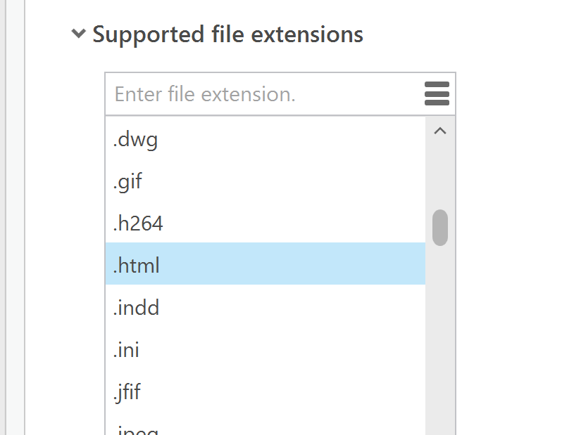

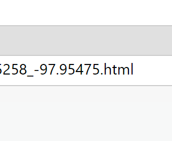

Ive found the security settings and added html to the list of recognized files. It is still not allowing me to click on the link. Perhaps there is another step?
dsmith5009
After reloading they layers, the link worked.  I needed to add the .html into the list of recognized file formats.

I was trying to use the link in the pop-up after clicking on a feature.  I had to go in and at .html to the list under the security section in the settings.  After unloading and reloading the features, it worked.
