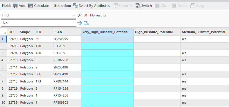

Hi there
I am currently using ArcGIS Pro 3.2.2 and have been trying to use the Find and Replace function within the attribute table with no success.
Reading past posts, it seems that this function has been implemented. I keep the Find field blank and it will show 'No results' when I can see that there is.
Any help would be appreciated.
Eugene_Adkins
Not saying this is your case but I have found in the past that there are times when a field appears to be blank but it is not - there is actually a single space in the field.
You could try selecting by attributes and then nulling the field. I have found that null fields can be easier to work with than blank fields.
