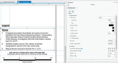

Hi everyone
Thanks Barry for your solution. I've implemented that into my notes section.
I'm wondering if anyone has solved this issue I'm having with the headings. I want to have a single heading reading "Notes" as shown in my photo. I've tricked it using the Position options (specifically Offset X) and some text formatting tags in Excel.
Is there a way to merge columns in Pro or create a singular table heading?

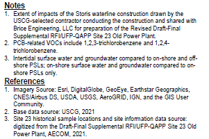

In a perfect world, I'd be able to create a numbered list with multiple headings like so:
ArcMap had an option to insert elements like word docs so the above screenshot was typed up in MS Word. Is there a way to recreate this in Pro?
Thanks!
TimothyFratta
Hi Olivia,
I too have run into this issue, i.e. placing an title over my notes that spans all columns. Alas, a. I cannot figure out how to eliminate the headings (my horrible solution? To reduce the font to 0), b. I don't think cell merge exists in ArcGIS tables, so I resigned myself to adding a text box above my newly created table.
It's a very bad compromise and I wish ArcGIS could provide better tools for text formatting.
Tim
