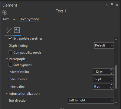

Is there a way to do this? I read a post about paragraph indent:
But the spacing between the number and the text that immediately follows DOES NOT align with the indent of the rest of the text.

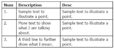

  • Create a standalone table--> add it to the Map
  • Insert it as a Table Frame into a Layout.
    • Right click on it click --> Properties.
  • Open the Properties of the Table Frame
  • The Element pane will set focus to the target field (Description) only.
  • Turn off Auto width --> Check on Enable word wrapping
The rest is formatting the Table Frame display to how you like it.

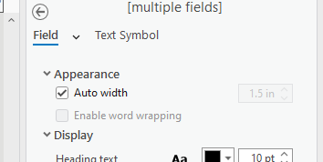

I was trying it today and cannot enable word wrapping, for some reason it's greyed out
Do you have any insights as to why?
Thanks!
Tim
TimothyFratta
Never mind, I simply needed to uncheck "Auto Width" 🙄

BarryNorthey
Watch the top of the Element pane. When you first start it signals [multiple fields] and deals with them collectively.
At this point you can set focus to a specific field in the Contents pane such as Description below and adjust its specific settings. The Element pane will show the field name Description at the top, not multiple fields and you adjust its width using the increment widget.

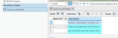

Your explanation makes most sense, alas my table (imported from Excel) does not break down the various fields:
As you can see, the table DOES have a field column called "N." and another one called "Description" but in the contents pane I only have "Notes_ExcelToTable" . . .
How do I insert a standalone table that has each field specifically called out?
Thanks again for your patience!
Tim
BarryNorthey
At this point, your table has been added to a specific Map (View) as a Standalone Table. You now want to Insert that table into a Layout (View) as a Table Frame. This is a Map Surround so the Layout needs to know which Map holds the table of interest. In the Layout:
  • Enter the Map Frame into the Layout that holds the Map with the table.
  • Insert a Table Frame and size and position as desired.  The Element pane should now be focused on the Table Frame in the Layout's Contents pane.  BarryNorthey_0-1720116214767.png
  • In the Element pane, designate the sources of the Map Frame and Table you want to use:
  • Click Show propertiesBarryNorthey_2-1720116259756.png at the bottom of the Elements pane. This will highlight all field name in the Layout's Contents pane and showBarryNorthey_3-1720116259757.png at the top of the Elements pane. Since all fields are selected, whatever you do will apply to all fields if allowed. At this point you can apply some settings to all fields and then refine them for each field by selecting just the target field in the Layout's Contents pane and adjust in the Elements pane.
