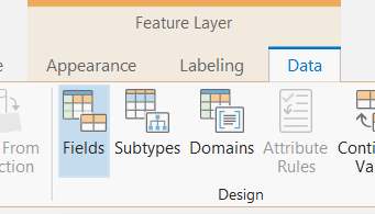

In ArcGIS Pro, I go to Data tab > Fields
and format the Percentage column to be Percentage with no decimals:

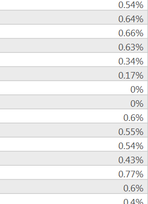

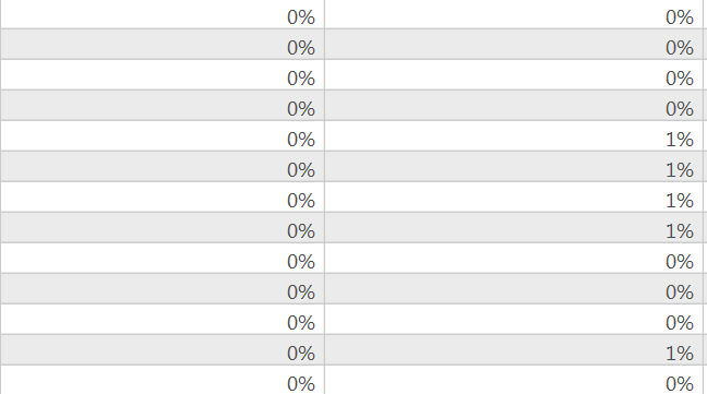

Instead, however, I see this:
Question: why does Pro round percentages when I specify no decimal places?
To resolve the issue, I try setting it to 2 decimal places, which yields this:
This is incorrect, because the values are actual 0.54, 0.64, etc. and I expect them to translate to 54%, 64%, etc.

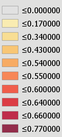

So I try to actually make a map for a slide with a legend (something the software is supposed to be able to do well, right?). I go to my Layout view, Insert > Legend and get this:
Yikes, what a mess. So now am I supposed to manually make a legend? I don't see another way to handle this.

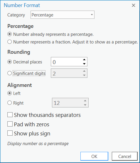

I am not an ArcPro User (due to its inability to access ms access personal geodatabases) however, Percentages is either a  format or a calculated value based upon the number stored in databases.  There is no field type of Percentage.  So the number is stored as a plain numeric or decimal value.  You would have to choose either:
1. Number represents a fraction.  Adjust it to show as a percentage  -- (Format)
2. Or apply a calculated value ([Percentage (your field name)]*100
Hope this helps....

I assume you have tried this option...
by Anonymous User
Not applicable
Your data is in decimal form (0.12, 0.25, etc.), also considered fractional format. Select the second option, "Number represents a fraction. Adjust it to show as a percentage". This will convert decimals to whole number (12, 25, etc.)
If your data were already whole numbers (12, 25, 63.24, etc.) then you would go with option one, "Number already represents a percentage".
