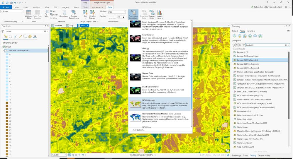

I don't know NDVI well but I found a good resource about calculating NDVI from Landsat 8 data - the formula according to this webpage is NDVI = (Band 5 – Band 4) / (Band 5 + Band 4).
Another workflow is to use Processing Templates in ArcGIS Pro as seen below.  Good luck!

Thank you very much.
Processing templates is a good solution. But then you have values. I still have to translate that into the classification according to the classes mentioned in the story map. Ask support ESRI Nederland how that works.
