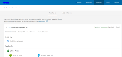

I think we are close to a solution. But when I tried to change from Creator user type to GIS Professional Advanced user type, it gives me this error: (please check the picture)

Please check if you are able to un-assign the ArcGIS Pro license from Add-on Licenses section. Then try again.
In case you can't un-assign the ArcGIS Pro license, please contact Esri Support to resolve your issue.
