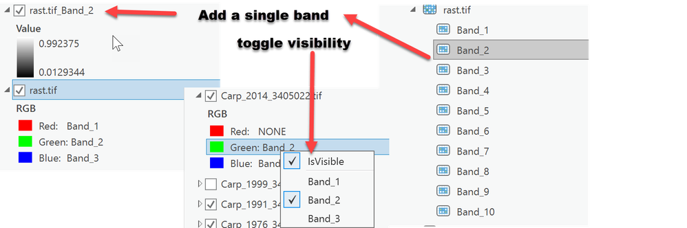

I either add the whole raster and toggle on/off the layers as needed, or more simply add one layer at a time (see above)

It works.. but its quite a step back in simplicity..
