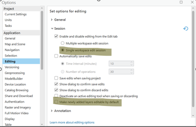

RaulRodriguez1
As a follow-up to this topic, we are testing a workaround with the edit settings in ArcGIS Pro. Below is a snapshot of the edit options dialog box, and the yellow highlights are the two settings we have changed (single workspace edit session and make newly added layers editing by default - off. This appears to allow multiple users to edit and save different feature classes, which are in different geodatabases. Is anyone aware of negative impacts of working this way?
RichardHowe
As I said to you before, this isn't what this is designed for, and I would make it standard practice at your peril. This simply replicates the old behaviour or ArcMap in requiring the need to "start" an editing session.
When I used to warn people off multi-user editing in a shared file geodatabase they would often say "But it lets me do it"...my analogy was always that a small family car would probably drive off-road for a while and you could get so far, but it's not what it's designed for, and when it does breakdown or get stuck you can't really have any complaints.
