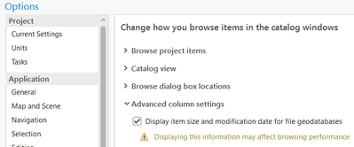

It looks like it is available from v3.0 per KoryKramers 8/10/22 post below. You may have to enable it in the Pro Options (see screenshot below) and note the comment about catalog browsing performance being affected.
